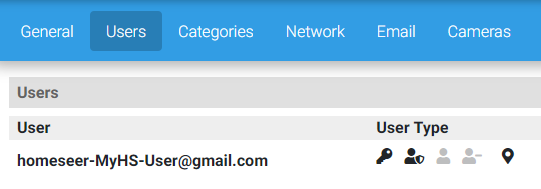

You'll need to add a user account to your HS4 system with your MyHS credentials and you'll need to enable Admin and Local permissions for this account. Once that's done, you'll need to enable voice commands for the HomeSeer devices or device features you wish to control with Alexa. Note that if you have multiple HomeSeer systems and a Premium MyHS account, you'll need to create unique MyHS users for each system. Please follow the steps outlined in this doc: Using Alexa with Multiple HS Systems. Then, follow the steps below:
Add MyHS User Account to HS4
Open your HomeSeer system's web interface and navigate to Setup > Users. Add a new user with your MyHS account credentials. Enable Admin and Local permissions.

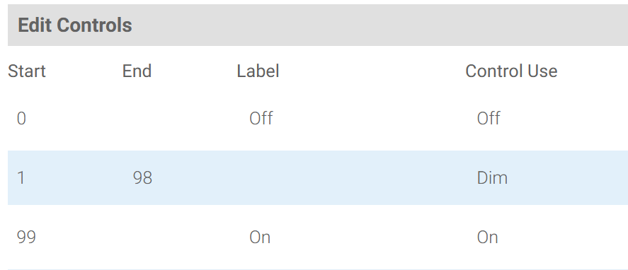

  • If a device is not appearing in the Alexa App, go to the device properties in HomeSeer, select the Status/Graphics tab, and make sure the control points have a Control Use setting set. This tells Alexa how to control the device. This value should be set by whatever plugin created the device but its possible some plugins are not setting this.

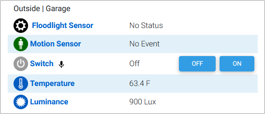

  • Device - Refers to a HomeSeer entity that represents either a physical product (like a smart switch) or a non-physical product or status (ie "virtual device"). Devices normally contain settings for a product so can usually be identified with the settings icon. In the example below, the Floodlight Sensor is the device.
  • Feature - Refers to a HomeSeer entity that represents an attribute of a device. In the example below, Motion Sensor, Switch, Temperature and Luminance entities are all features.
  • Controllable Feature - Refers to a feature that can be controlled by HomeSeer. Controllable features typically include buttons, drop down menus, sliders or some other type of control. In the example below, Switch is a controllable feature.
