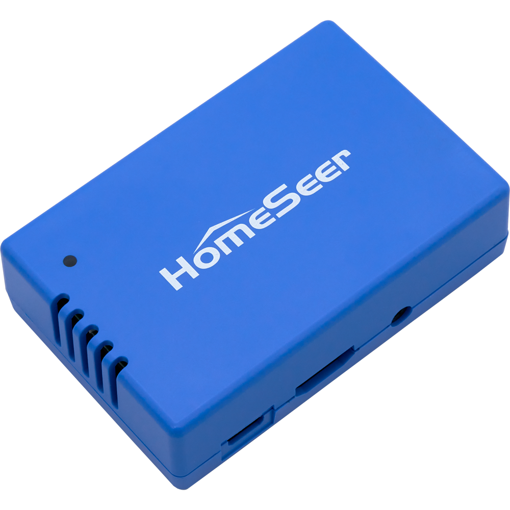

HomeSeer Hub Migration Guide
Use this guide for migrating from HomeTroller Pi G3 hub to a HomeSeer hub
Users who wish to migrate or upgrade from their existing HomeTroller Pi G3 hub to a HomeSeer Hub hub can easily accomplish this by following this guide.
Note that “interface” and “controller” are interchangeable terms that refer to the Z-Wave module (“HAT”) that’s physically installed on the HomeTroller hub.
