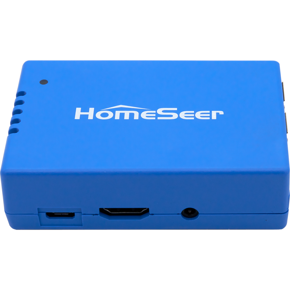

  1. Unpack the Hub and AC power supply. Connect an Ethernet cable to the unit and attach that to your router or network switch.
  2. Connect the AC power supply to the unit and plug it in. Wait for the LED on the top panel to turn green. This may take a minute or two.
