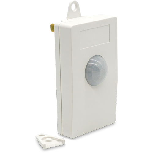

HSM200 is a Z-Wave multi-sensor that reports motion, temperature and light level using wireless Z-Wave commands. The product includes electrical prongs and is designed to plug into, and be powered by a standard US 120V wall outlet. HSM200 also includes an RGB LED that may be controlled by Z-Wave commands. This feature allows users to change the color of the LED to reflect the status of things in their home.  The unit has been designed, tested and certified for use in the United States and Canada.
