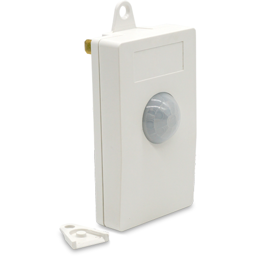

HSM200 Specs & Z-Wave Parameters
Specifications and Z-Wave parameters for the HSM200.
Specifications
Power
120VAC / 60 Hz, 1W
Z-Wave Frequency
908 / 916 MHz (US/CAN)
Z-Wave Range
300 feet minimum line of sight
Z-Wave Data Rate
9.6Kbps, 40Kbps, 100Kbps
Operating Temp Range
-20ºC to 80ºC
Motion Sensor Range
12ft
Motion Sensor Coverage
90º
Temperature Accuracy
+/-2.0C (-20C to 80C)
Temperature Resolution
0.1C
Light Sensor Range
0-10,000 LUX
Dimensions
3.25”H x 1.9”W x 1.9”D
Certifications
ETL (US, Canada), FCC/IC, Z-Wave Plus
