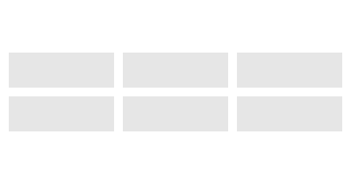

3-Column Grid
3x4
3x3
3x2
3x1

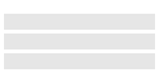

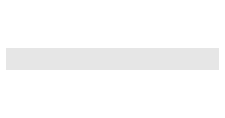

1-Column Grid
1x4
1x3
1x2
1x1
