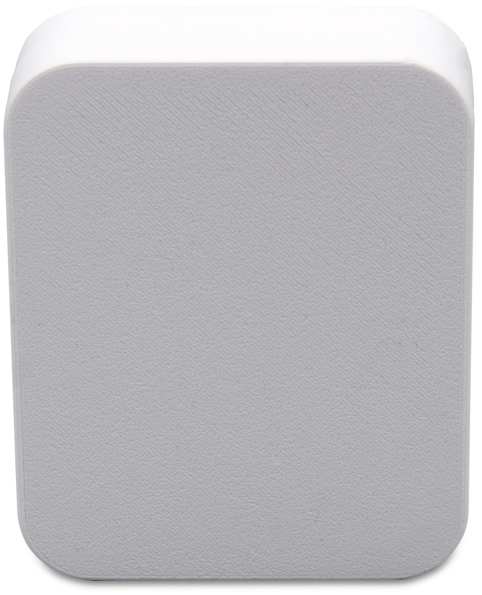

PS100 is a compact, easy to install presence sensor that uses mmWave radar technology to sense motion. It is designed to control other Z-Wave devices directly or it may be used with a variety of Z-Wave compatible hubs to launch events (automations). The latest version adds a second RGB LED. The 2 LEDS can be set to different colors independently.

  • The PS100’s 2-piece enclosure and shelf stand are both 3D printed at HomeSeer. Because of this, these parts may have some ‘artifacts’ or imperfections that are common to the 3D printing process but would not normally occur with injection molded parts. These imperfections are generally small and do not affect the functionality of the unit.
