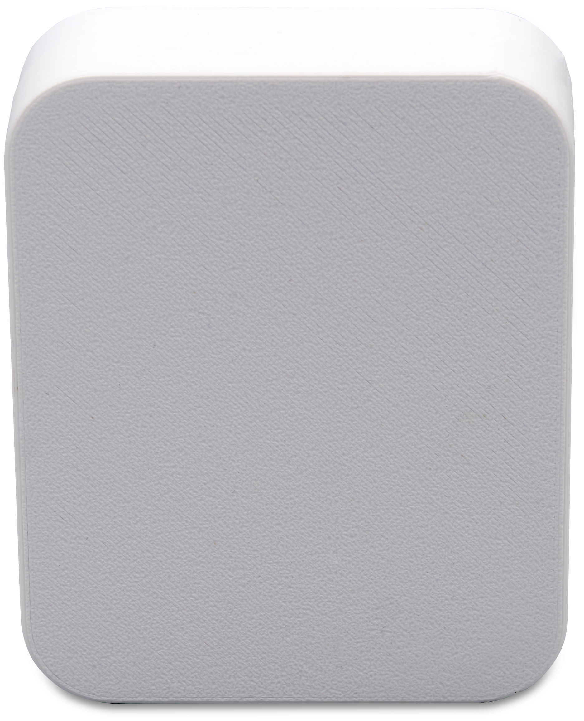

PS100 Specs & Z-Wave Parameters
Specifications and Z-Wave parameters for the PS100.
Specifications
Sensor Type
24 GHz mmWave radar
Power
5 Volt USB-C
Z-Wave Frequency | Line of Sight Range
908 MHz (US) | Up To 300 Ft (mesh), up to 1 mile (LR)
Detection Range
Up to 0-19.6 feet (0-600 cm)
Detection Coverage
120°
Operating Temp Range
32 - 104° F (0 - 40° C) | For indoor use only
Dimensions
2.99 x 2.40 x 0.87 inches (76 x 61 x 22 mm)
Weight
0.1 lbs (45 gm)
