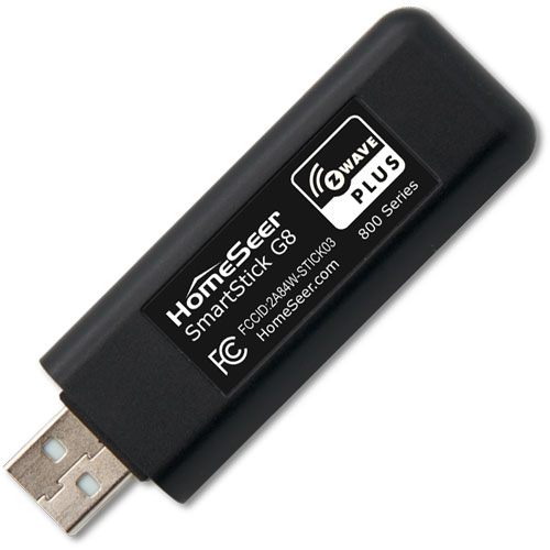

SmartStick G8 is a USB Z-Wave interface that’s designed to send and receive wireless Z-Wave commands to and from compatible smart home products in the home
SmartStick G8 is a USB Z-Wave interface that’s designed to send and receive wireless Z-Wave commands to and from compatible smart home products. SmartStick is compatible with most smart home systems including HomeSeer and Home Assistant software and hubs.

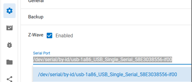

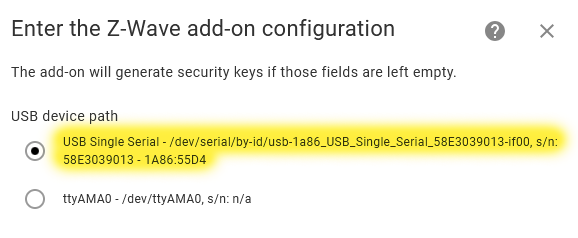

  • SmartStick G8 COM port will appear as a USB Single Serial device (as shown below)
ZWave JS
ZWave JS UI
