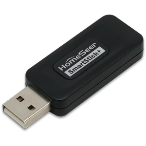

SmartStick+ G3 is a USB Z-Wave interface that’s designed to send and receive wireless Z-Wave commands to and from compatible smart home products in the home

  1. Drivers: SmartStick+ is a virtual COM device with a USB port connection. A software driver is required to allow SmartStick+ to work. The driver is available on homeseer.com/downloads (SmartStick+ Driver). HomeSeer Linux-based hubs are already equipped with the appropriate drivers.
  2. Physical Installation: Simply attach SmartStick+ to a USB port on your HomeSeer system. If the driver is installed, a COM port number will be assigned by the operating system. To confirm this, open your Windows Device Manager and expand the Ports section. Your SmartStick+ will appear as a USB Serial Device. In the example at the right, Windows has assigned COM port #4 to this SmartStick+. Your COM port may be different.

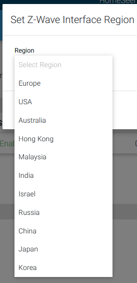

  8. If system is installed outside of the US or Canada, you'll need to select the proper Interface Region to enable communication on the correct frequency.
    1. Click the Set Interface Region button
    2. Choose the proper Region and save your setting.
