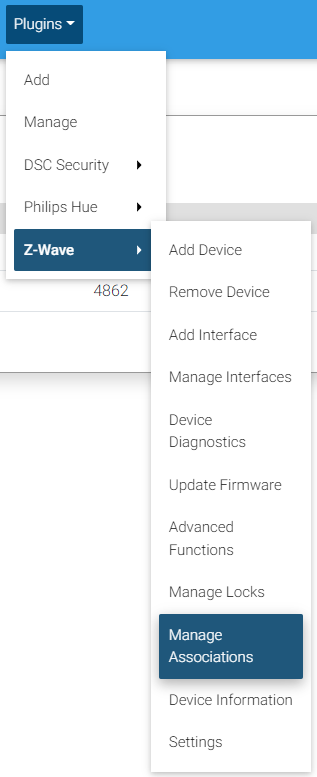

  1. Navigate to Plugins > Z-Wave > Manage Associations

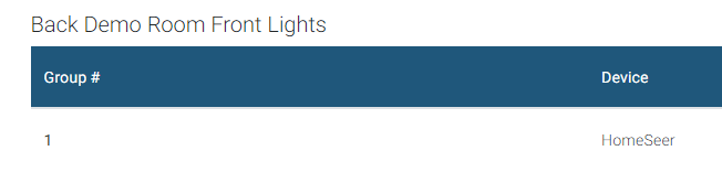

  2. Select a device in the first step of the wizard. This will allow you to see the existing associations

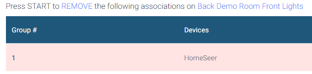

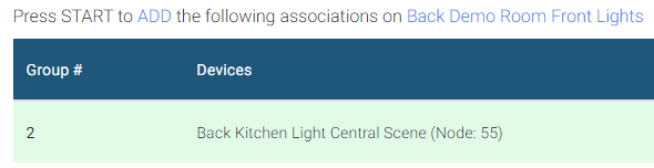

  6. At this step you will see an overview of the actions being performed. Click Start once the actions are reviewed and confirmed.
    1. Green rows indicate adding associations
    2. Red rows indicate removing associations

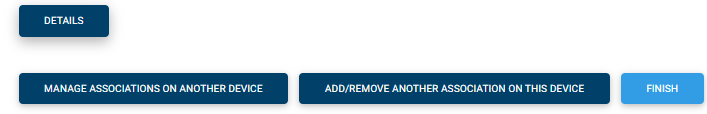

  7. Once completed, you will be presented with options.
    1. Details will show you a log of the actions
    2. Manage Associations on Another Device will bring you back to step one of the wizard.
    3. Add/Remove Another Association on this Device will bring you back to step two where you add/remove more associations to the selected device.
    4. Finish will bring you back to the Device page.
