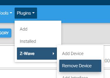

  1. Navigate to Plugins > Z-Wave > Remove Devices
  2. Click or tap Continue in step 1, then wait for the prompt to activate the "Remove from Network" function on your device.
  3. After you see the exclusion prompt, manually activate the exclusion process on your Z-Wave device. If you are unsure of what this process is, consult that device's documentation.
