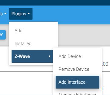

  1. Navigate to Plugins > Z-Wave > Add Interface
