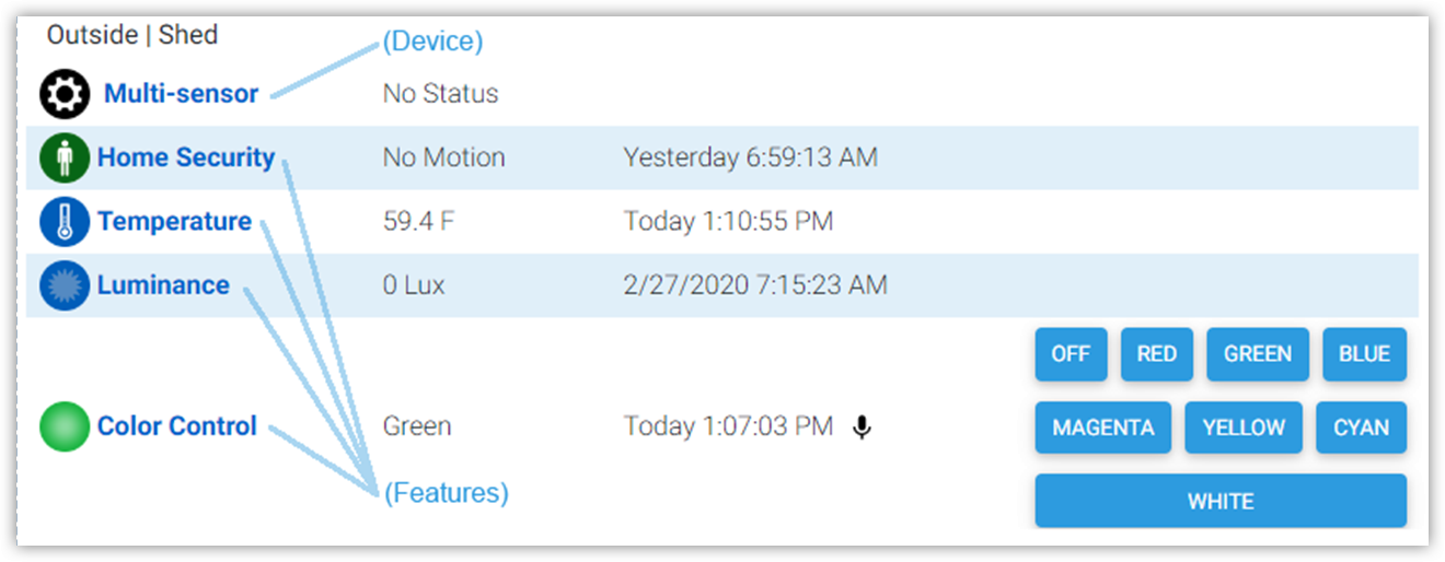

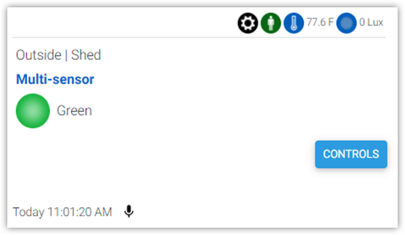

Devices are the fundamental building blocks for any HS4 system. When you add any smart product to your system, a corresponding device is added to the software. Device attributes will display as Features Some features are controllable and some will simply display values or status. When you turn the device on or off, your smart product will turn on or off. Here is what a multi-sensor device would look like in the HS4 device list & grid views:

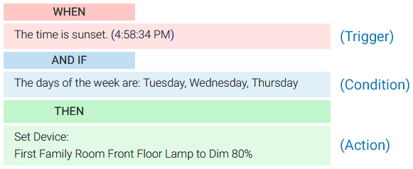

Creating Events
Events are rules that work to automate the smart devices in your home.  Each event is comprised of at least one Trigger and one Action. You may also apply Conditions to any trigger. In the example here, a living room lamp is turned on at sunset on Tuesdays.
For more information, Learn more about events.

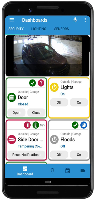

As of , HomeSeer offers (2) mobile apps, designed the access an control HomeSeer smart home hubs. Each is designed for a specific mobile platform. They are:
  • For iOS: HomeSeer Mobile - For information regarding installation and setup, please refer to HomeSeer Mobile
  • For Android: HomeSeer - For information regarding installation and setup, please refer to HomeSeer (mobile app)
