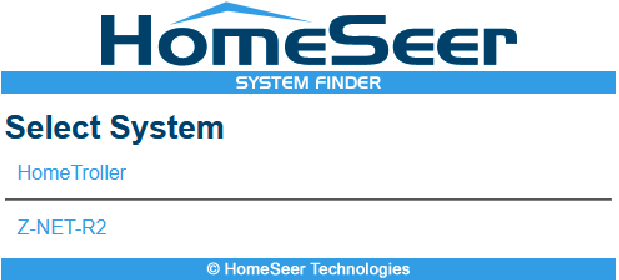

  3. Navigate to find.homeseer.com to access the system finder. You should see two links displayed, one for your HomeTroller hub (or HS4 system) and one for your Z-NET. If you don’t see the Z-NET link, wait for a few minutes and refresh your browser.

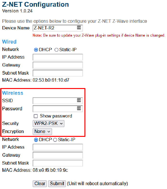

A wired Ethernet connection is recommended as wired connections tend to be more reliable. However, Z-NET may also be configured to work over WiFi if necessary. To enable WiFi, follow the steps below.
  1. With the Z-NET connected to your router (as described in the Initial Setup section above), navigate to find.homeseer.com to access the system finder. You should see two links displayed, one for your HomeTroller hub (or HS4 system) and one for your Z-NET. Click the link for your Z-NET (Z-NET-R2 in the example below).
  2. The Z-NET Configuration screen will now appear. Enter your WiFi SSID, Password, Security type and Encryption type into the Wireless section of the screen.
  3. Click the Submit button. The unit will reboot automatically and will then connect to your WiFi network.

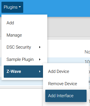

  2. Navigate to Plugins > Z-Wave > Add Interface to access the stepper for adding the Z-Net to your system.

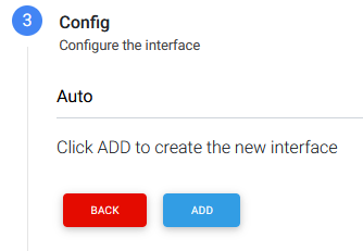

  3. Create a Name for your Z-NET, Select HomeSeer Z-NET Ethernet as the Model, and configure the interface by selecting Auto*, then Add. The Z-NET will then be added to your system.
