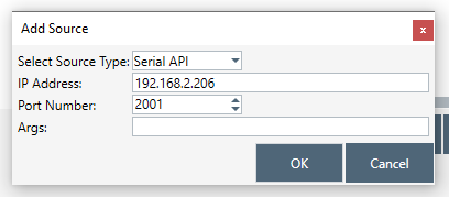

  6. Click on the gear icon at the top of the screen.
    • Z-NET: Click the Add button below and change the Source Type to Serial API, then enter the IP Address of your Z-NET and Port Number 2001 (our default Z-NET port setting). Then click OK.
