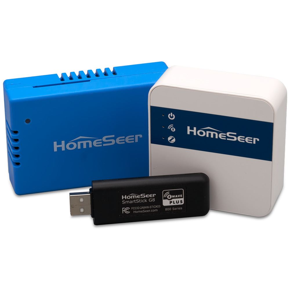

Z-NET PRO Migrating from Another Controller
Use this guide for migrating from a 500 or 700 series Z-Wave interface to an 800 series interface (SmartStick G8, Z-NET G8 or Z-NET PRO)
Users who wish to migrate or upgrade from their existing interface to an 800 series interface can easily accomplish this, but care must be exercised to avoid damaging (“bricking”) the interface. Follow the steps below to ensure the best outcome. Note: The terms “interface” and “controller” refer to the same thing and are used interchangeably.
